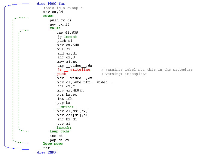

Pablo
22.06.2010, 05:56
Help me with C++
sphinx is interesting but needs to him a modern IDE like visual BASIC 2010, autoident, autotabs, guide lines, who helps the fast programming, clear and structured. this it is an example:
22.06.2010, 08:46
@ Pablo
Help me with C++
Hardly a necessary feature, IMHO. But I do think several editors support this (maybe not the connecting lines, but at least similar via folding), e.g. Scintilla, VIM, GNU Emacs, etc.

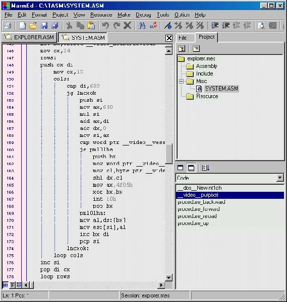

Pablo
22.06.2010, 12:33
MasmEd Code Editor
I locate several IDE's like Setedit, VIM, WinAsm and others in DOS and Windows ... very good, but the one that has some features to edit a DOS assembly code with the Visual Basic look, is MasmEd Code Editor 1.2.0.0. So far I believe that it is my favorite, although it does not have the capacity to detect possible errors.
22.06.2010, 16:04
@ Pablo
MasmEd Code Editor
MasmEd's home: http://radasm.cherrytree.at/masmed/
