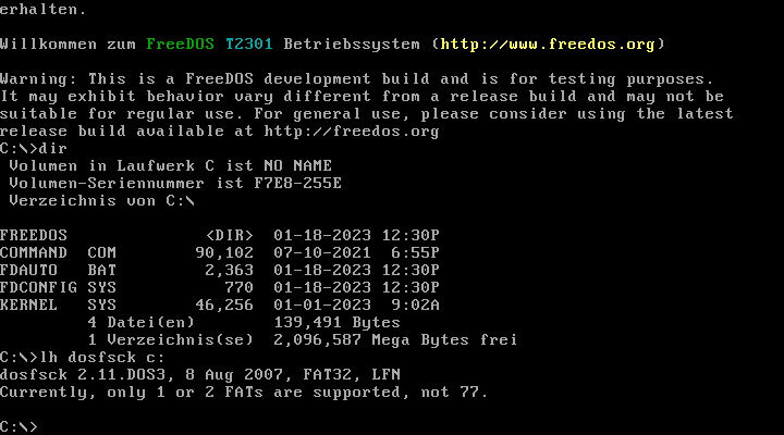

p) Rebooted and tried to install FreeDOS live CD FDT2301. It had problems with the
"move" packet and chkdsk (supports FAT 16 only) reports errors.
q) Rebooted and started live mode and dosfsck:
Dosfsck says: File system has -267 clusters but only space for 1.073.741.566 FAT entries.
(dots were added by me).

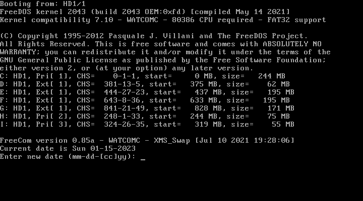

first of all I wanted to let you know that fdisk behaves strange on virtual hds that are a little bigger than 2 tb, see:
https://gitlab.com/FreeDOS/base/fdisk/-/issues/11
I would have expected that it says hd to big or no hd but that it works with the size bigger than 2 tb and creates this oversize as partition astonished me. i will try to find out what happens with 4 tb of size.
In the meantime I am able to create up to 7 smaller working partitions that behave like fdisk by using an extended partition and 4 logical volumes.
the trick is to enter the extended partition like in fdisk, save all this and with 2x enter you come into a new partition menu.
ranish shows a maximum size of 2 tb on the left top.

15.01.2023, 12:50
@ boeckmann
Ranish Partition Manager revived
> I also was able to put FreeDOS onto the partition and boot from it. But it
> seems that the FreeDOS SYS command puts new boot code into the MBR, which
> could not successfully boot the partition. I had to uninstall the SYS
> provided boot code with RANISH using the "uninstall boot manager by loading
> standard IPL" command. After that FreeDOS successfully booted.
I don't think that SYS specifically does that. You can read the source code and point out if you find it writes an MBR anywhere, but I don't think it does.
How did you install FreeDOS onto the disk? There probably is a part of the installer that will / can write an MBR loader.

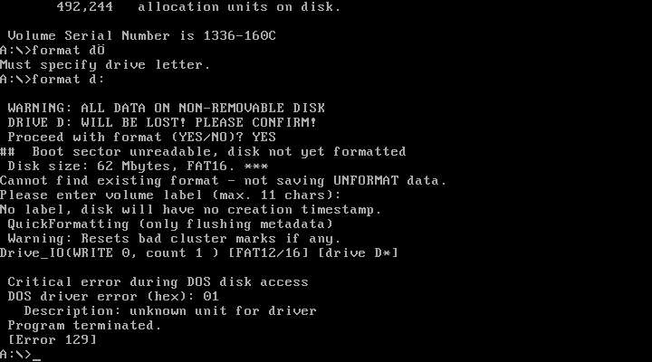

fritz.mueller
Munich, Germany,
15.01.2023, 15:32
Hi
I just tested the latest ranish with a virtual 1 GB HDand still have some questions with it.
a) How can I create 3 partitions, an extended partition and more than 4 logical volumes?
b) When creating partitions, it would be helpful to show the maximum number of sectors for this partition in the window. otherwise you always have to calculate the max. value.
c) maybe this is the problem you mentioned before: I created all partitions with ranish, everything was shown green, I rebooted FD and tried to run format,
format c: worked, at all others format reported an error message:
Warning: Resets bad cluster marks, if any.
Drive_IO (write 0 count 1) [FAT12/16] [drive d*]
critical error during disk access
DOS driver error (hex): 01
Description: unknown unit for driver
Program terminated
I started ranish and formatted d - i, rebooted, and now everything works fine.

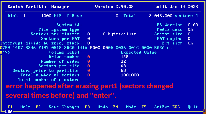

d) among others I got an interrupt divide by zero, see screenshot.

boeckmann
Aachen, Germany,
15.01.2023, 16:14
@ fritz.mueller
A few hints Fritz: If you want to delete a partition press DELETE. You may set the partition type to "unused" via INSERT but that does not alter the size of the partition nor deletes it.
The erase function does not erase the partition itself but fills it with zero. That is primarly usefull if you want to erase all data in that partition. Therefore the menu entry is called "Erase partition DATA". Perhaps it should be named differently to avoid confusion.
The crash in the picture results in trying to display FAT file system information on a partition previously filled with zeros. That is a software bug. I will implement some checks to make sure that screen is only accessible on a formatted FAT partition.
If there is interest I can try to make a screencast or something in a tutorial style howto create complex partition layouts.

boeckmann
Aachen, Germany,
15.01.2023, 18:49
> it
> which
> loading
> read
My bad, there wasn't boot code at all in the MBR. It was a fresh virtual disk image. So I think it was a BIOS message.
I simply did a SYS to put the OS onto the disk.

There is another thing that I noticed with a 2 TB HD. dosfsck reports an error message with 77 FATs, I could not test it once again at the moment, but I assume it is reproducable. But I think this is a dosfsck bug.

fritz.mueller
Munich, Germany,
18.01.2023, 12:50
@ boeckmann
referring to dosfsck: It works with 32 MB, but only run it with lh dosfsck c:
At the enclosed picture you can see the 2 TB HD (I created it in virtualbox with ranish, rebooted, formatted it with ranish, executed a sys c: from FDT2301 and installed FD basic + dosfsck.
The result is that it reports that only 1 or 2 FATs are supported, not 77.
Should I report this at Gitlab too?[image]
As FD format has problems with this size I do not test it with FD format.
Thanks for reading
boeckmann
Aachen, Germany,
18.01.2023, 14:05
@ fritz.mueller
> Hi,
> c:
I tested it with a 137 GiB disk (thats all my BIOS supports), a single primary FAT32 LBA partition formatted with RANISH. Dosfsck reports no error here. Perhaps it is the 2 TiB size that makes problems with dosfsck. Have you tried it with a 2TiB - 1 GiB partition?
fritz.mueller
Munich, Germany,
18.01.2023, 14:48
@ boeckmann
> > Hi,
> dosfsck
> > c:
I tested it again todaywith the 256 GB SSD HD and got the value 67 instead of 77.
I made a lot of screenshots, available, in case you should need it. Simply send a mail to fritz.mueller near mail.com.
Ranish worked fine with this 256 GB SSD HD, there were no 13% messages at ranish version of format and verify. At the moment the machine runs with FD fdisk c: (already done) and now with format c: /U /S - but this is at 6 GB now, will last a while. For documentation purposes and easier understanding it would be helpful to see different words at the format / verify progress bar window, although it is cosmetic.
I ran some tests with "coming back from logical volume" but could not yet reproduce it. Will report when I know more.
boeckmann
Aachen, Germany,
18.01.2023, 21:15
@ fritz.mueller
> of 77.
I also tried it now under VirtualBox with a 2 TiB disk. dosfsck tries to allocate ~268MB memory, which it fails to. That is exactly the size of the FAT table, so my guess is it tries to load the table into memory as a whole. Interestingly memory allocation also fails if the VM has enough RAM. There seems to be some maximum memory allocation size. Skimming over the XMS specification my guess is that there is an block allocation limit of 64MB (maximum DX value, function number 09h).
I had success in checking a 256GB disk.
If loading dosfsck via LH as you suggested I immediately get the same error code as you. I think it is not working correctly if running with LH.
