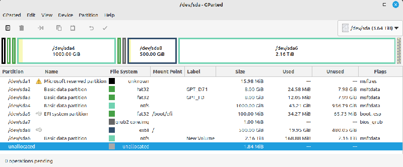

> > > Also works for a GPT 4TB SSD SATA drive with 8 GB DOS 71, 1 TB
> > > Windows 10 and 500 GB Mint 21.1(grub 2.06), and 2200 GB NTFS
> partitions
> > > (but Windows could not be made to triple boot).

Problem with editing /etc/default/grub
sudo update-grub (no edit changes)

sudo -i allowed permission to sudoedit /etc/default/grub which originally was
# If you change this file, run 'update-grub' afterwards to update
# /boot/grub/grub.cfg.

edited /etc/default/grub to include MSDOS stuff stuff added at the end

### BEGIN /etc/grub.d/30_os-prober ###
menuentry 'MS-DOS 5.x/6.x/Win3.1 (on /dev/sda2)' --class ms_dos --class os $menuentry_id_option 'osprober-chain-5230-F0FE' {
insmod part_gpt
insmod fat
set root='hd0,gpt2'
if [ x$feature_platform_search_hint = xy ]; then
search --no-floppy --fs-uuid --set=root --hint-bios=hd0,gpt2 --hint-efi=hd0,gpt2 --hint-baremetal=ahci0,gpt2 5230-F0FE
else
search --no-floppy --fs-uuid --set=root 5230-F0FE
fi
drivemap -s (hd0) ${root}
chainloader +1
set timeout_style=menu
if [ "${timeout}" = 0 ]; then
set timeout=10
fi
### END /etc/grub.d/30_os-prober ###
sudo update-grub

/boot/grub/grub.cfg listing

menuentry "Windows Boot Manager (on /dev/sda5)" --class windows --class os $menuentry_id_option 'osprober-efi-202E-600C' {
insmod part_gpt
insmod fat
set root='hd0,gpt5'
search --no-floppy --fs-uuid --set=root --hint-bios=hd0,gpt5 --hint-efi=hd0,gpt5 --hint-baremetal=ahci0,gpt5 202E-600C
else
search --no-floppy --fs-uuid --set=root 202E-600C
fi
chainloader /EFI/Microsoft/Boot/bootmgfw.efi

How to fix the editing of /etc/default/grub to make sudo update-grub include MSDOS?
EDIT to ORIGINAL POST
![[image]](img/uploaded/image238.png)
/dev/sda2 is where MS-DOS 7.1 is located (label GPT_D71)
