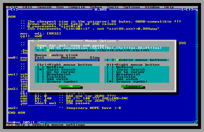

Free Pascal questions | 2.2.2 test | FP IDE test @marcov
marcov wrote (in other thread):
> How does the textmode FPC ide fare?
Average, see below. Since you are deliberately participating in my text editor crashing challenge , hope you won't get too angry if I report some bugs :-P
> Do you have that file online?
Sure: WOW (2.3 MiB)
> Note that the FPC textmode IDE has a limit on 256 char lines. Less of a
> problem with sourcecode, but with other files it can be limiting.
IMHO doesn't qualify a fault, as least for a text editor.
20.10.2008, 09:01
(edited by DOS386, 20.10.2008, 09:21)
So the results:
- Pretty feature-rich, see shot above :-)
- Doesn't have the mouse-cursor-ghosting-bug known from FD EDIT 0.9 , at least as long as there is no 25 vs 50 problem, see below
- Loading my 15 MiB file is a bit slow, there is no progress indicator and no abort, but still acceptable, minor thing, finally loads correctly.
- Editing this file seems to work, well responsive.
- Critical BUG : pressing CTL-C in the hope of copy into clipboard triggers an internal error and aborting :-( IMHO CTL-C CTL-V and CTL-X should be supported and work (they are not advertised in current version ...). C&P using the alternative ways seems to work.
- Can't drag the scrollbars, but there is "GoTo Line" , so minor thing.
- Too long lines: no crash, lines got force split into pieces per 255 bytes at most, minor problem: instead of reporting the amount of evil lines, it reports the same thing twice, one time as "line -1"
- S&R with single confirm seems to work well
- S&R with "replace all" has problems. Maybe it's somewhat "correct" , but very slow (hog new memory and move complete text for every occurrence ?), strange cursor activity, no progress indicator, and no abort :-( As a minimal P.I. the line number field active while editing could be used, the optimal solution would be 2-pass and a S&R progress box like:

- 25 vs 50 lines: it seems to store the height into (at least) one of those numberous CFG/INI/.../??? files, and starting it next time in the "other" height doesn't work (no mouse, at least ALT-X intact). Deleting those files helps. Also there in no internal 25 vs 50 switching support (works well in INFOPAD, in FD EDIT it's present but doesn't work)
- Calculator: starting with 7 and clicking "x^2" ... after overflowing 64-bit, it switches to float (probably intentional), but few clicks later when float range is over as well the punishment is considerably harder :crying:
For copying text into clipboard press CTRL-ins
paste text: Shift ins
delete selected text: CTRL del
I like these combination more than windowish CTRL-C or CTRL-V because it works with russian keyboard loaded too.
(CTRL-C doen't work with russian keyboard, because it makes completely different ASCII code than programer thought. It is a problem of most windows programs too, by the way)
20.10.2008, 18:09
(edited by marcov, 20.10.2008, 23:38)
While that works, but I usually use ctrl-k codes. iirc ctrl-k g allows to get block from other window.

21.10.2008, 12:17
CTRL-C is a problem too because it is "terminate program" on nearly all commandline systems.

@ marcov
Sufficiently easy to find in edit menu and seems to work :-|

I'm not the ultimate doshead, but I KNOW what ctrl-C means in dos, and it is not copy, that's truly Windows.
But if it is REALLY that important to you go to "options ->environment->mouse options" and stop whining. :-D :-D :-D

There is nothing (see shot) :-D
If I select M$, the edit menu gets adjusted and CTL-X and CTL-V start working. So the aforementioned "flaw" doesn't exist in FP IDE DOS, rather very good design :-)
> and stop whining.
Regrettably the BUG is still in - CTL-C crashes in both CUA-91 and M$ mode. Except, of course, (since I KNOW what ctrl-C means in dos ) CTL-C indeed means "Cause Crash" :-P
