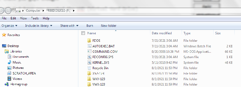

I believe that I have now mounted the VHD (Virtual Hard Drive)
I created three subdirectories...
XYZ-123
WXY-123
VWX-123
Can a couple of the experts here confirm or refute this ?

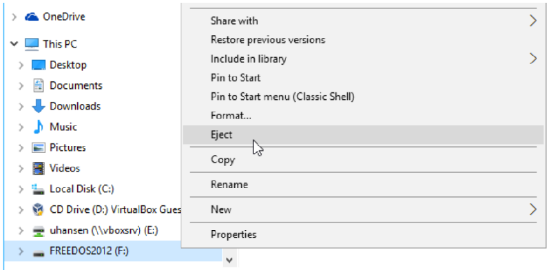

If I have properly mounted the VHD (Virtual Hard Drive) so that I can put files from Windows in and out of the drive that FreeDOS sees, the next step which is on that Wiki page says...
"...If you are done, please take care to eject the image before you startup the FreeDOS guest in VirtualBox...."
That page then shows this image...
I do not see the "...EJECT..." thing on my screen.
I see this instead...
...i.e., He has the word "EJECT" Between the words, "...FORMAT..." and "...COPY..." while I do not.

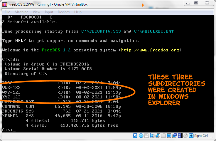

I went through that process (i.e., Detaching the VHD) then started FreeDOS in Oracle VirtualBox, and the three directories which I created (i.e., "XYZ-123", etc.) appear as shown here...
Did I actually get this right ?

most likely, yes.
actually, you could have created files in these directories with known (to you) content, and verified that this known content still exists when running in DOS.
so you wouldn't have to ask - and wait for answers.
