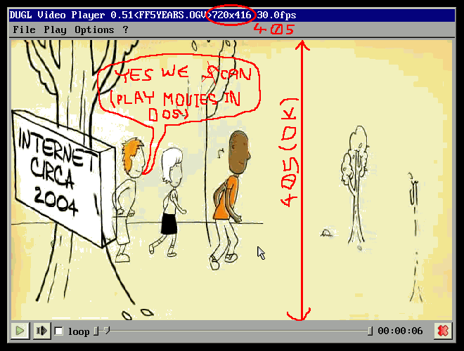

- OFFSET BUG: movie is OK but displaying the size without the offset removed (??? retest needed)

OK, I retested and the BUG is indeed in there (see ^^^ shot). DP correctly trims away what should not be visible (416->405, excellent FFTheora decoder AFAIK doesn't ...) but it reports the untrimmed size (416).
2 more new issues:
- BUG: if I specify a filename on commandline, it crashes (used to work in 0.50)
- [F11] causes a "deformation" if X/Y movie's aspect <> DUGL's X/Y aspect. Solution: "best fit" (doesn't DUGL VIEWER already do this ???)

Ok, However, after compiling with DJGPP 2.03, DUGL Viewer exe is now only 229kb instead of 285kb, so near to 60 kb size reduction ;-)
OK
> 2 more new issues:
> 0.50)
Yes this is an old and ugly issue, so should be fixed ..
