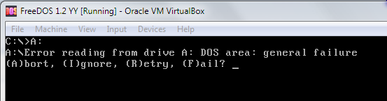

I was Wondering if I already have a Floppy Drive, "A:>" or not
So, I pressed "A:" on the keyboard.
I saw this on my screen...
Does that mean that I have a virtual Floppy "A:\>" drive or not ?
If it exists, how do I put a file in there ?

you have an empty floppy drive.
you have to put a virtual diskette into it, just as in real live.
