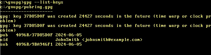

Repeated test with the specified config.
GPG hangs again, repeating key generating message twice:
echo g=ffff:0|debug>nul

Thanks for trying again and posting your screenshot. Is this MS-DOS 6.22? What's it running on?
Yesterday i tinkered with sample.c and sample.exe from the NOISE driver. I learned that /dev/random$ will effectively block indefinitely after the NOISE driver entropy pool becomes empty. It won't generate random bytes unless it has sufficient entropy. The documentation says that the NOISE driver's entropy estimation is relatively conservative.
Yesterday i was able to work around it by adding the /d flag to include disk timing data into the entropy pool. I generated about a half dozen or so RSA keypairs on MS-DOS 6.22 running in qemu, and it rapidly succeeded every time.
From your screenshot, my guess is that GPG was able to read enough random bytes to generate the first half of the key pair, and it blocked in the second half because the NOISE driver ran out of entropy.
The documentation states that you can collect entropy ahead of time. This is just speculation on my part: Maybe it would help to do something disk intensive before generating a keypair? The most disk intensive thing i can think of is compiling a big program with DJGPP. :-)

I think it worked for me because i was generating 1024 bit keys. When i tried to generate a 4096 bit keypair on MS-DOS, it failed, presumably because it was blocking on an empty entropy pool in the NOISE device.
I posted gpg14c.zip which honors the RNG_DEVICE environment variable. If you set RNG_DEVICE=/dev/urandom$ then GnuPG will use that when it generates keys. This will guarantee that it never blocks on an empty entropy pool, but i will reiterate that the documentation warns against doing this.

Moreover, every time (tried three times) GPG generates keys with dates in the future:

Thanks for your gpg.con contents. How do you test whether they are being ignored?
> the future:
Before generating keys, try:
set TZ=PST8PDT
rosegondon
C:\DOS,
17.05.2024, 22:03

But why key creation dates jump randomly? This is not constant shift in date.
I never saw such GPG behavior.
bencollver
19.05.2024, 05:53
@ rosegondon
GnuPG 1.4.23 for DOS
> date.
It was DJGPP's fault. GPG gets the key creation timestamp from time(2). On DJGPP, time(2) uses gettimeofday(2), which in turn uses mktime(3), which relies on the TZ environment variable in order to produce correct results. When the TZ variable is invalid or unset, time(2) intermittently gives incorrect results. I am not sure why it is intermittent. The timestamp may be correct, or it may be set weeks in the future. If i generated a key with a creation date weeks in the future, and then ran "gpg --list-keys" several times in a row, then any given time it might give a warning, and the next time it might not.
I found that i could work around this using:
SET TZ=DOS0
DOS0 is not a real time zone, but it is valid POSIX TZ extended format. The "DOS" part is just a name and the "0" part means zero hours offset from UTC. This assumes that the hardware clock is set to UTC. A normal DOS system has the hardware clock set to local time, not UTC. In my case i have:
SET TZ=PST8PDT
