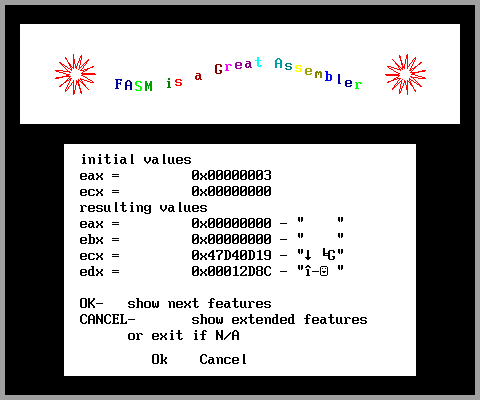

LOGO works now (see shot) ... :-)
CLOCK doesn't (strange, it used to crash on exactly same addr :confused: ), and the GPF's in Ring 0 persists :-(
It's NOT a regression of HX ... and also not because of CTM 2.1 ... no idea why I couldn't discover it before if this bug is really old :confused:
Also, the minor MessageBox bug got fixed (see shot) :-)
